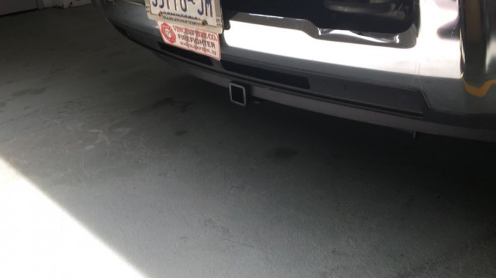

I put the Curt on my '13. The Drawtite was too high in my opinion for putting bikes on the front. Now they're perfectly level with the hood. But that is going to depend on which bike mount you get.

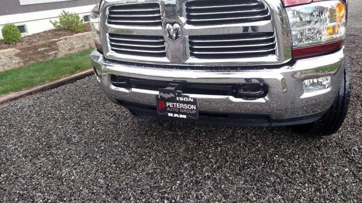

I went with the Draw-Tite
Line pull: 9,000 lbs
Vertical load: 500 lbs
Gross trailer weight: 5,000 lbs
I like the higher position for the looks and it's better for winching, but I use a drop hitch to lower it a bit when I transport my generator on long trips down into Mexico. No big loss of airflow this way. And no cutting into the dam below.

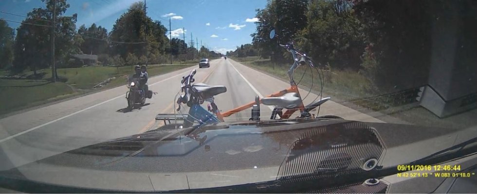

I went the Curt route, which, according to eTrailer, also has a 500-pound vertical load rating.
https://www.etrailer.com/Front-Hitch/Ram/3500/2015/C31067.html?vehicleid=201517729
I guess the amount of bicycle in your windshield view is somewhat based on the type of bike carrier you are using. I went with an RV rated carrier which I highly suggest because you have the flexibility to hang the carrier on the back of an RV. I wanted the lowest receiver I could get and that was the Curt.
The install was easy, I did it myself (2015 RAM 3500) with the help of a floor jack. Notching the air dam, well, no big deal.
As you can see, the windshield view is non-obstructive (pardon the dash-cam picture) and as far as restricting air flow into the radiator, not even close to an issue. Keep in mind the orange bike looks like it is sitting high, it isn't. I'm very tall and need an XL frame hence the reason it sits facing the passenger side.

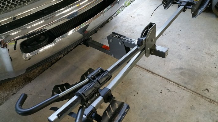

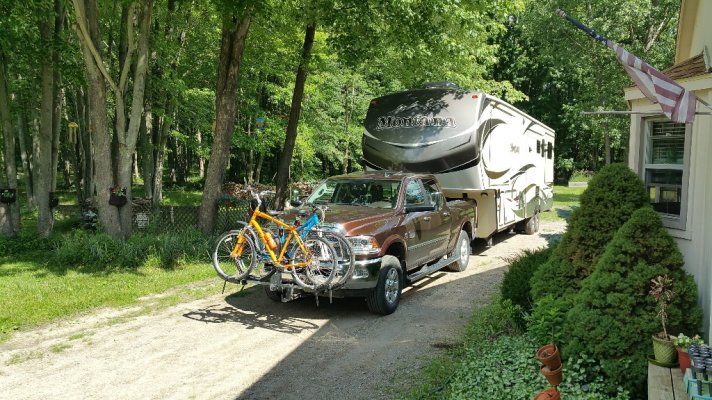

I would highly recommend the Swagman bike rack (dependent upon number of bikes carried of course). I did have to modify mine, for 2 reasons.
1. Wanted to raise the rack just a little bit (about 2").
2. Arm that came with bike rack was too short to use on the front of the truck. Rear bike would be in the grille.
Now it sits at the perfect height, unless you get into some extreme off roads, which I never plan to bring the 5th wheel into.
Bikes sit securely in place with no movement at all. Bike rack comes with a bolt instead of a pin so the hitch is tight inside the receiver, absolutely no play.

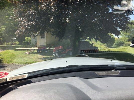

And finally this is the view from the drivers seat. Bikes are just tall enough to know they're still there but don't interfere with the view at all. When I modified the hitch I set it so that I could still open the hood with the bikes on there if I had to.
Been running this setup all year and have had no issues with cooling as of yet.
