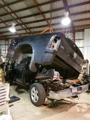

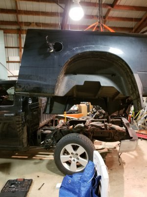

Thanks in advance for any responses- I have a 2009 ram 1500 sit with hemi, 170k, recent starter, battery, and crank position sensor. It has randomly stopped running when I was at a complete stop or moving slowly, which I thought was caused by the battery connection. Last time it happened was 4 days ago. Yesterday i wnet out to start, and just a click. Moved the negative terminal and then it started right up. Let it run for a few minutes, tben after driving a few miles, it felt bogged down when I gave it gas. It felt like my cj7 with a bad carb. Got off the highway and into a commuter lot, and shut it off. When I tried to start it, it cranks, but won't turn. I also don't hear the fuel pump hum when I turn the key. I tried banging the fuel tank, no change. No codes on the scan tool either. Fuse for fuel pump is fine. Would it be a safe guess to say it's the pump?
