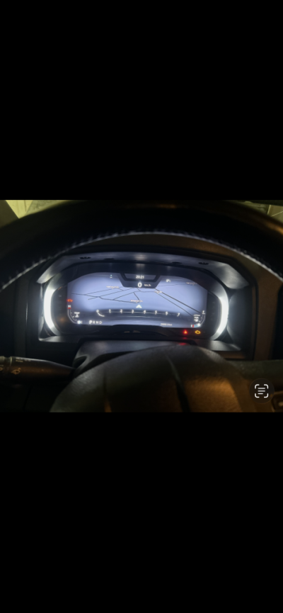

Reyokonova will be designing the 3d printed bezel adapter bezel and I will be designing the canbus modules .
This mod will be done in stages .
Ultimate end goal is getting full cluster navigation working in the cluster .
I have navigation working in my truck but will need to test more things on his truck before moving to that stage .
One will need to use 23/24 hd full digital clusters .
1500 full digital clusters will not work at all .
I just got a module flashed for him and he will report back the behaviours .
