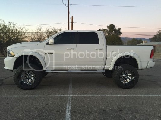

Nice , hope it serves you well Sir !
Center bolt to center bolt for the crossmember is 6". The differential drop bracket center bolt to center bolt is 4.5"
One of the best looking trucks on here! What offset are your wheels?
I love the wheels! Did you buy them local or online?
Looks wicked - props man. Any cutting to get that FTS kit in?
I'm sure the front, rear cross member brackets would need to be cut off to allow clearance for the front differential to drop just like any other lift kit on a 1500. Shouldn't be any more cutting involved than that though.
Beautiful Truck Sheengon. I have had the same debate for a while now. My debate was between FTS and Wicked Customs. I ended up going with Wicked Customs because they build a true 8" lift instead of the 6 that FTS does. I am scheduled to get mine in May. I haven't decided if I should go with the 3 inch body or not yet. How does yours handle/ride? Are you going to go with bigger tires instead of the 37s since you did the 3 inch body?
Love the truck...
what gears do you have if you don't mind me asking?

I don't have measurements yet. Planning on making them soon. It rides better than stock. The shop owner that did the suspension install was so impressed with how smooth it rides he wanted to keep on driving after the first test ride. Even after the suspension re-torqueing, he just couldn't believe how awesome the ride on this rig is given how tall it is with 37s and 14" wide wheels. Total price for lift and install was $2500. FTS uses the stock shocks but I decided to go with the Bilstein 5100 for another $370. FTS offers 2.0 reservoir shocks but were too pricey. They are currently working on their own coil over design but I'm not sure if they are released yet. FTS is also currently working on designing a 10" lift for 4th gen 1500s.
I'm looking for about 9-10" of lift with the same setup as you - 22x14s and 37s. My question is what is the advantage of getting the FTS 8" with my bilsteins over let's say just a 6 inch zone with maxed bilsteins? I'm trying to go an affordable route while still using a quality setup.
I would ask someone with a 6" Zone kit to measure the distance between the bolt holes on the front cross member drops to see what it is (true 6" or not) and how long the steering knuckles are. A Zone 6" kit by itself actually provides 5.5" of lift. So it wouldn't surprise me if their drop brackets were only 5" or 5.5" of drop and same with the increase in length of the steering knuckles. If that's the case, the FTS kit will handle maxed Bilsteins better than a Zone kit will.
