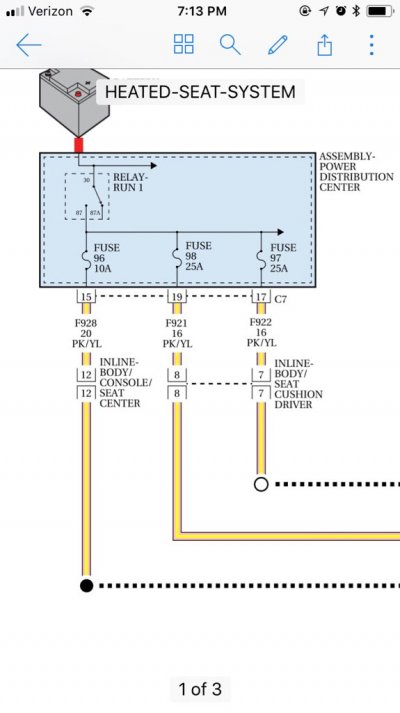

Whipped myself up a Micro2 current loop today and checked the 79, 97 & 98 fuses for any current moving through them, nada on all three.
Deerguy (or anyone else really), do you have a pinout diagram for the C7 connector? I need to find out which pin is for fuse 79.
-K

Did you do it with the key on? They are on a relay.
Yup, checked in both ACC and RUN. Given that I don't have the features those fuses connect to, I wasn't expecting any current draw through them but this now tells me it's worth my time to figure out how to get under the TIPM and see if the C7 connectors are populated or not. (Now that I think about it, I wonder if I can get my inspection camera under there and look without pulling it out...)
-K
Noticed another one too, I have a 30amp fuse in place in the Air Suspension Compressor slot and I don't have that feature either. I'm begining to think they have two TIPMs stocked at the factory "Tradesman" and "Everything Else"

Here you go. I have a 2016 2500 Tradesman and I have all of these populated with fuses, just not wires under the PDU.
Thanks!
Interesting... The owners manual and the TIPM cover has F79 simply labeled "Clearance lights". This appears to show it feeding from the trailer running lights relay, yet the owners manual lists F29 as "Trailer Tow Parking Lights". And, of course, that was the one thing I didn't have connected (a trailer) when I tested. <sigh> More testing needed. Need to find my trailer wiring load test box...
