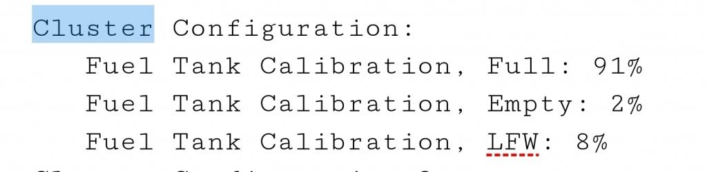

Guys I mentioned it in my post above but awhile ago I posted in 2 seperate posts on calibrating it using the AlphaOBD app on my android phone and an OBDII blutooth adapter.
In the body control module you need to correct Capacity Liters to 121 under Cluster, Vehconfig3, Ecuconfig4. Then under Cluster Calibration I used these values for each.
Just a warning, read up about AlphaOBD if you plan on making these changes. Before any changes SAVE your STOCK settings and backup the file. Most people use google document to have it forever. This is for "just in case" you make a wrong change you can always go back.
Again, I know of NO dealer that can or will make these changes. If anyone has, let's hear it.
For example below is a screen shot of only one of the settings.
May I ask why you chose 91% as "full" (as opposed to 100%)?
And do you know what the "LFW" value is? Is that when the warning light comes on? Like "Level Fuel Warning"?
