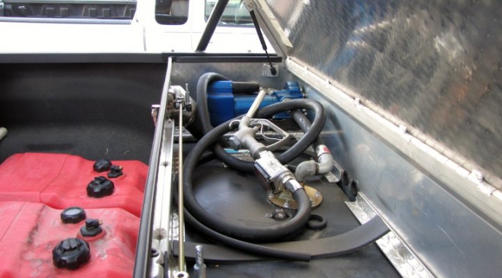

My old 2009 Dodge Ram SLT Quad Cab 5.7L had a factory 32 gallon tank
That gave me around 360 Miles
I needed more, so i installed a 30 gallon Transfer Flow tank/tool box
IT had an electric pump for fuel transfer & then i also had three 6 gallon Boat fuel tanks, that gave me 80 gallons of gas

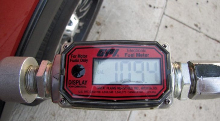

So you're saying the Prius was also mis calibrated by having the incorrect capacity in the programming? Because that's what I'm saying. Before I had put the correct capacities into the program, it would be on a HARD E on on the gauge yet only take 26 gallons on a 32 g tank. The LOW fuel Light would come on and say 50 mi til empty when in actuality I had 90 miles til empty. RAM numbers are way off and I'm clearly not the only one that pays enough attention to it to notice.

Found the same on my 22 limited 2500. Build says 31 gallon tank but with 5 miles in range, allows just shy of 26 gallons. Looking forward to a remedy.

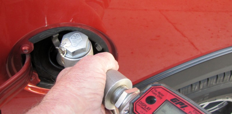

Don't know if you guys saw earlier in this post but I adjusted mine and now for every 1/4 mark on the gauge is worth 8 gallons. And Empty means it! Though I don't run it that low intentional but now I know if I fill off my 92 gallon reserve tank at 1/4 tank reading on the gauge I know I'm using 24 gallons of my reserve. This is why it was important to me to read accurate. I travel/haul so I need it accurate for fuel stop figures and such.

I start looking for a gas station when my tank goes below 1/2 tank, when i am traveling where there are no cities & very few towns.
