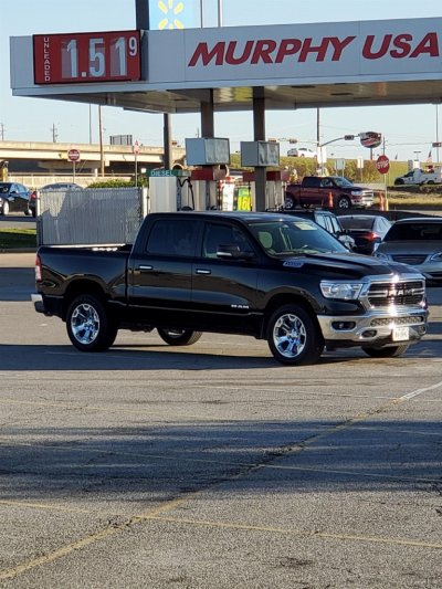

I haven't changed my profile bio yet but its a 2020 1500 lonestar lvl 2 2wd
Black 20 Ram
Damn, I wish gas prices were that low where I live. Just because I'm curious, why didn't you buy a truck with the 3.92 gearing in the first place?
Couldn't find 1. And the ones I did find weren't in the price range and were 4x4.
That pic was taken back during the summer. Its about 1.889 right now
