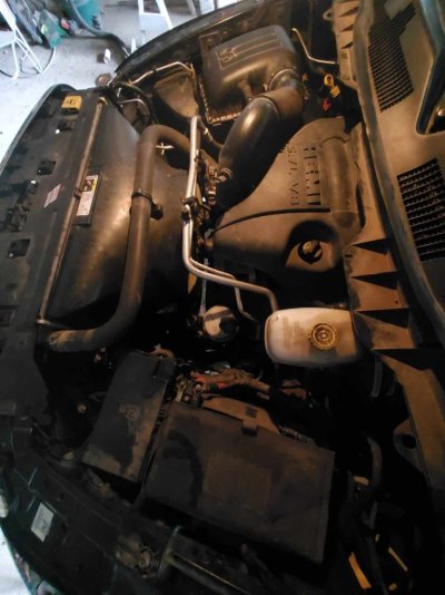

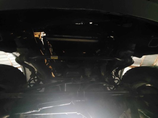

Update! The truck is back home. I'm just going to post the invoice here in the hope that someone more knowledgeable than me will glance it over and let me know if everything seems to generally be in order. Any suggestions on caring for the truck as we break it back in would be appreciated.
I'm told it needs new suspension components and plan to do that work myself, probably in late January. Haven't looked this all over myself yet, but again I welcome any and all tips, recommendations, etc. that might help me and future readers out. Thanks and happy holidays to you all.
Edit: added a few pics.

Dump the 5W-20 and run a good quality 5W-30

Thank you and yep, it's getting some Red Line before it goes another mile.
