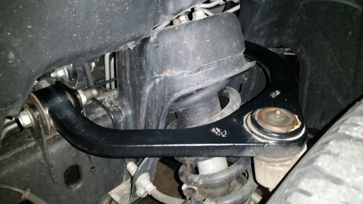

For the OP , and anyone else for that matter .
Some have had an issue with the origination of the Mevotecs as far as right & left go .
Most of us paint them right away , then get them mixed up because the P/N isn't on them ....
To help with this look at these photos I just took of my Mevotecs installed now for about 27,000 miles .
Drivers side :
Passenger side :
Notice how one side of the Mevotec UCA'S has more of a bend or is crooked . This crooked side goes AFT towards the rear of the truck.
Hope this helps someone in the future .
