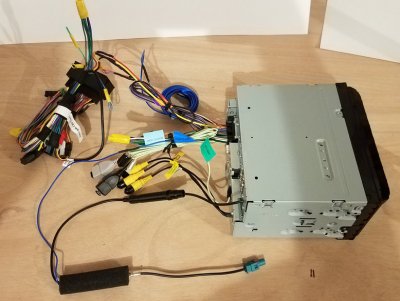

So here is the HU wired to the iDatalink CH3 Harness. Not much going on here.
The wires just above the USB cables are the HU speaker output wires. Since I am going RCA to amps, their is no reason to connect them so they are taped off. The same goes for the CH3 harness as you will see the yellow tape on the end of the wires to the upper left. I could have connected them, it would have caused no harm. If you are just replacing your factory radio and using your existing speakers, you will need to connect these.
The only other wires in that bundle that are connected are the Parking Brake and the Antenna Control. The Parking brake is just grounded to the chassis of the radio to bypass the safety function. If you want to maintain the feature, connect that wire to the similar labeled wire on the CH3 harness. Quick note, this is for Kenwood ONLY! If you are running a Pioneer or other, you may need to add a relay, check for your particular model. As for the antenna control, I am using a Metra antenna converter that has an AM booster built into it so the Blue wires powers that.
The wires that are connected to the CH3 Harness are as follows;
Red - Accessory Power (Turns the HU on)
Yellow - 12v+ (The actual power source to the radio. Some people confuse the yellow and red, red tells the unit to turn on, yellow carries the power)
Black - Negative
Orange - Illumination (So the radio dims with the headlights coming on)
Purple / White - Reverse (So the radio shows the reverse camera when putting the truck in reverse)
The only other wire left is the P-Cont wire which is used to turn on my amps. While I do have an existing solution for this, I figured I might as well use it since I am running RCA cables anyways.
attachment.php
All in all, not a lot going on here. There are 4 connectors in the top bundle that will connect to the Maestro unit as well as 2 from the Maestro to the HU but no additional wiring is required. You'll of course have to run your mic and GPS puck but that is self explanatory.
RCA's and the iDatalink USB trickling in today and the Maestro main unit tomorrow so I'll probably do the install on Saturday. Fingers crossed! ;)
