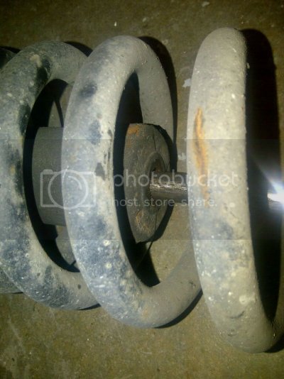

What a day. I really didn't need all this to happen this month. Shop tore into the truck today. Both front struts blown and leaking. Thought the rack and pinion was blown but ended up being oil leaking on it from the oil filter not being tightened down. Both sway bar links replaced, both tie rod ends replaced and the passenger side CV driveshaft boot was split and leaking so had that replaced also. Total $900.
Here she is up in the air
Blown strut
