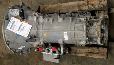

I'm trying to understand though - how does this "valve" relates to changing 8 speed fluid on our Ram's?
The thermostatic block ion those transmissions is part of the TMU on the side of the Ram truck variants of the transmission. The TMU also has engine coolant piped to it for faster warm up. There is a three way valve that directs coolant through the TMU when not needed by the cab for heat.
The TMU is the square thing on the side.
I have to wonder how much if any fluid drains out of the transmission cooler when the bypass is not sending fluid to the cooler in the condenser.
