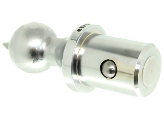

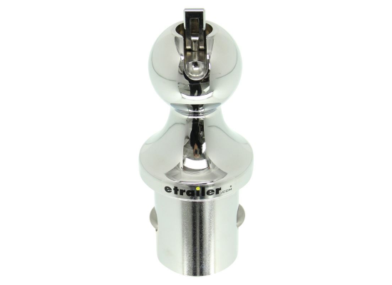

I just ran across this post on etrailer. Hope it helps.
Thanks. I just checked it out but being the top is cut off it's hard to tell if that's the type I have. Of course, the hole down the center could be an indication it is. It's snowing right now but I will get up in the bed, first chance I get, and see if I can see if there is anything left of a locking pin inside what is left of the ball. I would guess if it was all removed the ball can be tapped/beat out as the ball bearings would have nothing holding them out. If not, perhaps the remainder of the locking mechanism can be tapped from the bottom up and out?

My Curt ball was stuck like yours. The ball bearings rust and won't retract into the ball. I bought a 4 pound dead blow hammer and beat on the sides of the ball like a madman. After about 5 minutes the bearings loosened up and I could remove the ball. Since the top part of yours is cut off you will need to weld a pieced of bar stock to what is left of the ball. Then beat the bar stock like a madman. ;-)

With these Curt balls it is not a matter of pulling or beating it straight up. That will never work since the ball bearings that hold the ball in usually rust and won't retract. Soaking it with PB Blaster or Kroil will help but you need to beat on the thing sideways to get the ball bearings to loosen up and retract.
