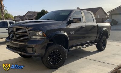

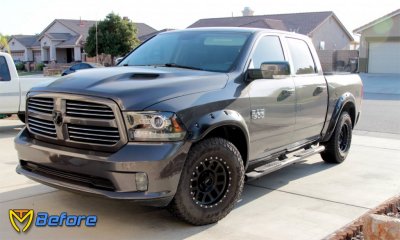

Well, I got my MaxTrac lift kit installed, then went to get an alignment. Prior to the alignment, I had no issues with tires, alignment, or electronics. Immediately after the alignment, the truck pulled left, and the wheel is cocked right. The alignment shop was a joke, I went back and he just made excuses telling me it was 'tire runout'. I had 40-50 miles on the truck between lift kit install and alignment.
Then today, I got an indicator to have my trailer brakes serviced, then it says the above message, and the 'burnout' indicator is lit up (I know, it's a Slip, Stability Control indicator). I'm not currently using my trailer brakes, so I have no idea why I'm suddenly having these issues.

I never had any issues with my Maxtrac lifts and they drove like new. Maybe when they took apart the front spindle, they messed something up?
I wasn't thinking it was the lift kit... even though it needed an alignment, it was driving straight and didn't pull at all. As soon as I left the alignment shop, it pulled to the left and then a couple days later the wheel was way off and the codes appeared.
