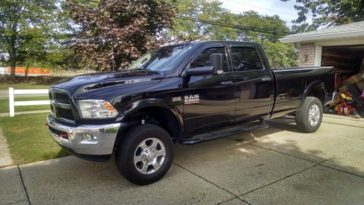

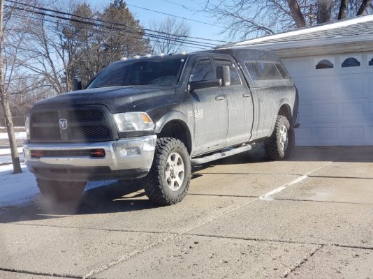

Hi Mike, yes you will definitely need an adjustable track bar to re center the axle. With the level kit, it will pull the axle to the left and your steering wheel will be off center to the left. I went with RC track bar.
I also installed the RC steering box support, can't hurt.
I have had my RC level kit, track bar and support installed for almost 2 years with no issues or complaints. And I have not had to align it yet.
Oh, you will also want to adjust the caster bolts on the trailing arms by turing the bolt one notch aft, This is recommended by Thuren.
First pic just finished level install, second pic current state of mods, only cleaner.

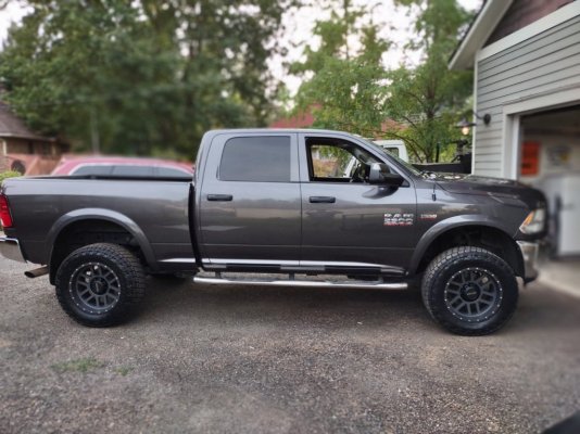

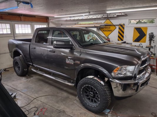

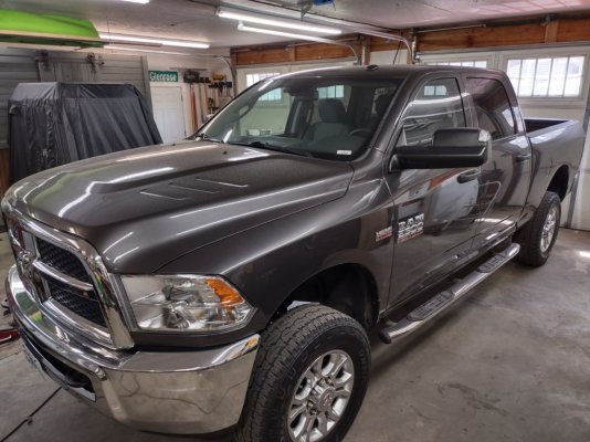

It's been a bit since I posted, but I got some parts installed today. I've been lazy, and it's been super hot up here in the PNW... Not used to temps over 100 for that long.
The level kit went in easy enough, and it was good to get the new Bilsteins on there as well. It still had the originals dated 2013..lol
I still have about 1/2" of rake, which is exactly what I was shooting for.
During the test drive, I did notice that the steering wheel was a bit off center. It drove straight, but clearly needs the track bar. I ordered one from Core4x4. It seemed like it's overbuilt, so It'll be more than I ever need.
Outside of that, I still have some cosmetic things to wrap up before the wheels and tires go on.
Another shout out to all the guys on this board. I've got my pretty base Tradesman sitting pretty with the 8.4 conversion, and an EVIC cluster from a Power Wagon that looks awesome with the VP4.

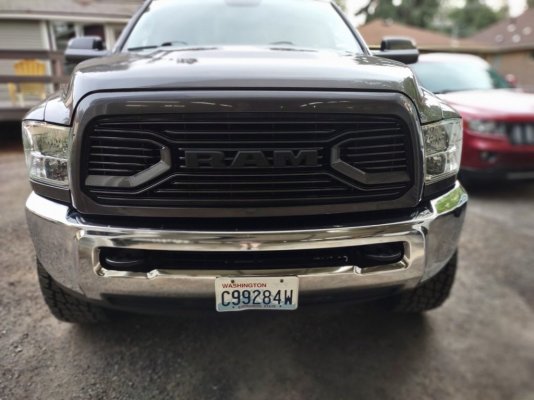

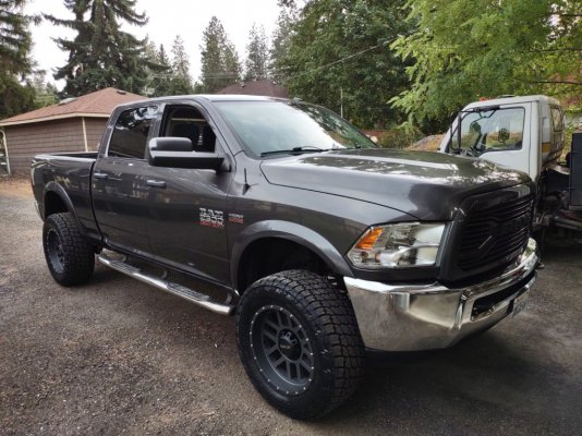

Well, I got it mostly done. I just have to install the track bar, and order the TBV..
It got all the parts I listed above, plus the flares, grill, VP4 and Power Wagon cluster.
Thanks again guys, it's been a really easy build with all the help from this forum!

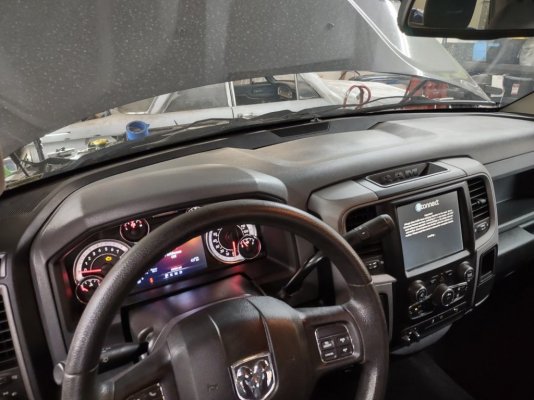

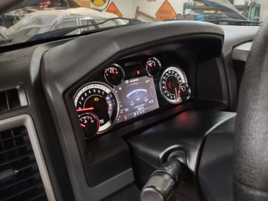

The dash is a nice upgrade from the uconnect 5.0 and the tiny 3" display that came stock
