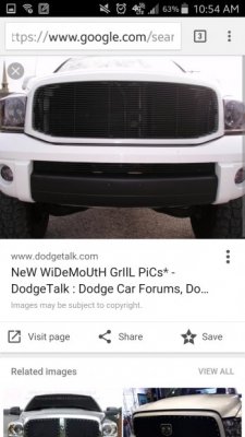

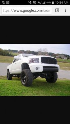

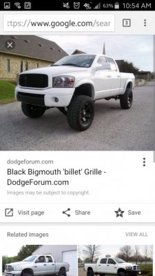

Been searching everywhere pretty sure I've ready the post 100+ times. Can anyone tell me how to get my front end like this?

That's an aftermarket grill screen and a stock bumper painted up in black and white.
Those bumpers were found on 2500 QC's and MegaCabs and on the 1500 Sport model trucks.

The chrome stock? I've found the grill it's the bumper and grill assembly I'm confused on. So i would need 2 sand down and paint the bumper and grill assembly or is it something in could ebay?

The stock bumper covers I've seen in that style are paintable and I think they come either painted or primed, ready to paint. The grill shell on your truck can be reused and you can paint that any color you want. The grill insert looks like a simple painted mesh panel cut to fit the grill shell.

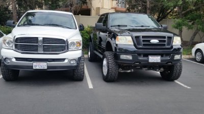

So if I understand Correctly I order that bumper cover then get the necessary parts paint on that take the grill assembly a loose from the dodge cross bracket paint the chrome assembly and install the black billet grill inserts?
This is the front of my truck

That sport bumper may take a different set of mounting brackets as well.
But, essentially you are correct. Get the parts, paint them how you want them, pull the grill shell and insert out, paint as you like, put any inserts in you want and mount it all up.

The bumper you are seeking to install is a 2 piece part as opposed to the current bumper you have which is one piece with a top part matching the light contour.
The 2 pieces bumper you want has a inner bumper with a complete plastic cover which is the part you paint to match your desired look.
That being said, nothing stops you from buying the grille/insert and then use some Plasti-Dip or equivalent to reach the look of the above shown bumper using your current chrome one. The benefit of the plasti-dip is that you do not have to go through sandblasting the chrome off of your bumper to paint it, and if you don't like the result, you can peel it and redo (as long as you have applied a thick enough coat it peels off easy, often in one piece...). It is also a very durable and low cost alternative to change the look of your front end.
Just a suggestion.
