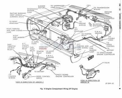

Trying to make a complete list of ground locations for these first gems
Right now I got:
One near windshield wiper motor
One right of the steering column
Two near battery negative terminal
Ground behind #6 valve cover
One on the alternator
One on the thing that looks like an alternator but isn't
One near the starter relay
One behind the radio
The two horns are grounded to the frame via the mounting bolts
There isn't one on the starter itself
No grounds on the tranny or transfer case
I think theres a ground near the tail lights
Any grounds I'm missing?

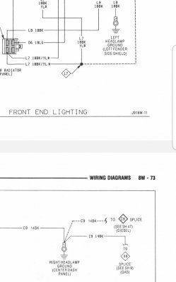

Apparently theres a ground either near the right headlamp or near the center dash panel.
