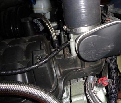

Hi guys very interesting thread. My idle isn't very steady and hope the grounding will smoothed it.
But someone could do some pictures of his installation please because I don't know exactly what to do.

Crimp an eyelet onto a chunk of 14G wire that's big enough to fit over the throttle body bolt,make the wire long enough to run over to the batteries negative post,or else crimp another eyelet on,and run the wire to the stud on the fender behind the battery.It's pretty simple if you look at it.

Here you go
I used 12ga wire and attached it to the fender bolt on passenger side.
Zip-tied it along the firewall and intake.
8mm bolt on the throttle body, 10mm on the fender ground.
I immediately noticed a smoother idle but nothing else. I'm happy.
