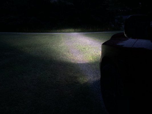

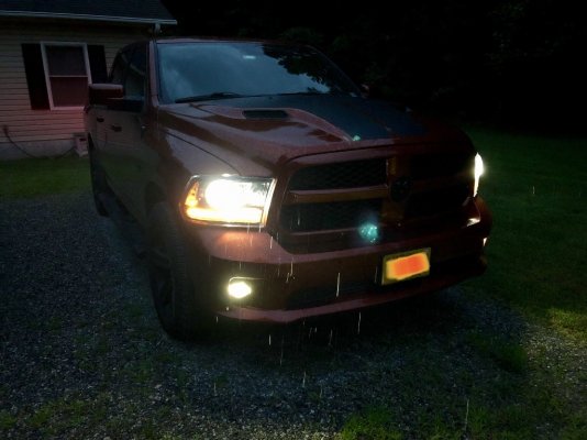

Starting to rain and not quite dark, but here’s some pics. DDM Tuning Plus Canbus 35w ballasts w/ 5500k HID bulbs. Morimoto XB LED Fog lights, also 5500k.
Phone made the lights look more yellow. The auto adjust made it difficult to get decent pics. Very clean white to my eyes in person:
Off:
DDM Tuning low beams + Morimoto XB Fogs:
DDM lows (driver seat):
DDM lows + Morimoto XB’s (driver seat):
