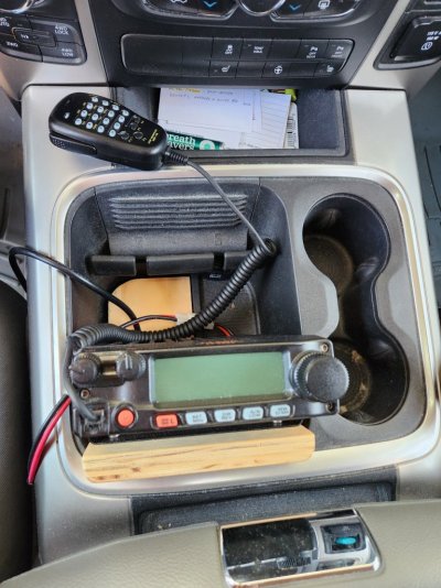

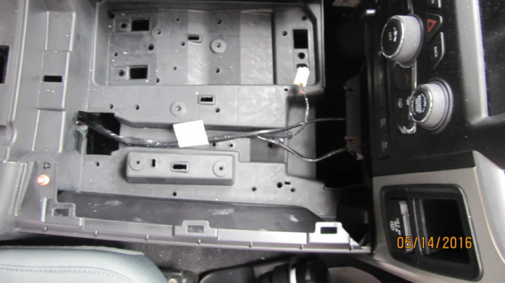

This is how I mounted my FT-2890 in my 2016. Cut two pieces of plywood and shaped them to the open storage bin in the center console so they fit snug. Used 2 metal angle brackets to hold the two pieces of wood together. It works for me. The only issue I have is I would like to secure a mic holder to the dash and don't want to drill any holes so the mic lays in the console too. I've tried double sided tape on the mic holder but to comes lose in the summer heat.

Nice job, i don't have a console. I'm planning on removing the drawer that i have, but found i need to remove a bezel just to get to the screws to remove it. Yeah i'm planning on trying adhesive to attach the mic holder, i have some Adhesion Promoter that might help.
I found a hole with a plastic cap under the back seat to run the antenna coax through. 3d printing a replacement cap that i can fit the cable through then seal back up.

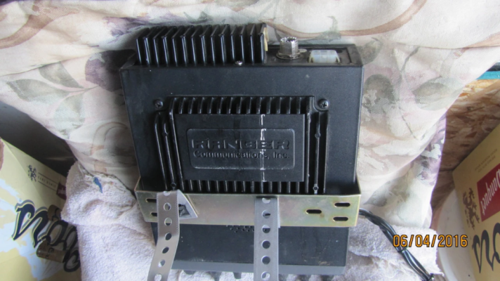

i run a CB & i wanted a clean setup
I am running a bit of Boost & i have a Squirrel Cage Fan blowing on the Heat Sinks
I had the same radio in my 2009, as i now have in my 2016

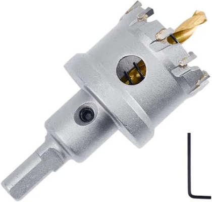

Use a tool like this to cut a hole to size
