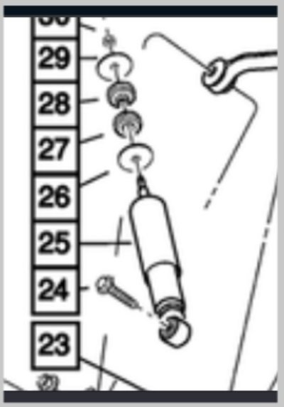

Can you post a video of the noises on YouTube and post a link?
Squeak noises are often caused by dried-out bushings in the front struts. They can squeak every time you cross a ridge or bump on the pavement.
Set up a step ladder next to the front bumper, place your foot on the bumper and rapidly bounce/compress the suspension.
If you hear the squeaking noise, it's definitely suspension-related. While it could be several different parts in the suspension, I believe the struts are the most likely and a good place to start.
Buy an aerosol can of white lithium grease and spray the rubber bushings shown below as #27 & #28. This is a band-aid solution and will require reapplication depending on weather and driving conditions. I sprayed my GF's car about every 4-6 months.
And welcome to Ram Forum.
