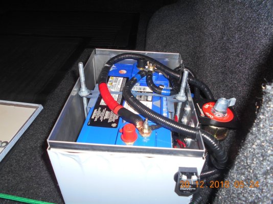

Use a wire grommet to run wires into the fuse box. My battery was relocated to the rear corner of my box,and i had more then a few wires run into the fuse box.I also had a stand alone fuel cell in the box with it's own fuel pump,and a bottle heater on the nitrous bottle,so my truck had a pile of extra wiring,including what's generally called the "Big 3" wiring upgrade The ones that i didn't run up from the bottom of the fuse box,ran through a grommet in the side of the box. Sometimes you gotta think outside the box :Big Laugh:
Stand alone fuel cell is at the front,with it's own high pressure fuel pump,relocated battery in the back box,and my NHRA legal Master Disconnect switch in the rear bumper,which was wired to shut down the underhood fuse box,the only way you can shut down a late model Ram is also kill power to the fuse box,along with killing power to the battery. The big ole switch on the battery box killed everything,turning it off was equilevent to removing the battery,and if the truck was going to sit for anymore then a couple days,i flipped it.
The nitrous and gauge switches were in the console,and the master disconnect switches to kill those switches was under the flip up console lid,so you might say my truck had it's share of extra wiring, ;) . I could turn the power off to the pillar gauges , as coming home at 2:00 in the morning after a long day at the dragstrip,i didn't want them lite up and staring me in the face on the 2.5 hour drive home from the dragstrip.
My 15lb nitrous bottle was behind the drivers seat,and easy to reach from the drivers seat to open the valve,and it was hid in plain sight,inside the suitcase. Many so-called nitrous guru's went over my truck looking for the nitrous system,and never found it,nobody ever thought to look inside a suitcase in an older guys truck,all the wiring and hoses under the hood were disguised to look like factory wiring and hoses :Big Laugh:
