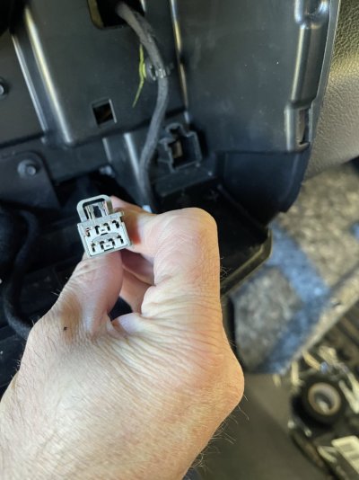

Hello! I've been searching around, so I apologize if this question has already been asked. I own a 2016 Ram 1500 Express, and I removed the radio only to find a harness end behind it that appears to be inactive. I'm curious if anyone knows its intended purpose or if it can be utilized for something else. Thanks!

Pictures of the harness might help but more than likely the unused harness plug is for options like heated seats/steering wheel, front/rear park assist, etc.

Apologize. The photos were in the wrong format. I fixed it and posted them.

That plugs into the AC outlet module on the passengers side of the dash center bezel.
