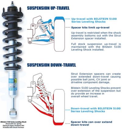

You can add bilstein 5100 shocks adjustable shocks to your front end. They have 4 height settings and for you to get your truck to be leveled you would want them se at either 2.1 or 2.8

how do the shocks compare to a bolt on leveling kit?

And the shocks will give you a smoother ride

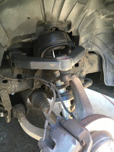

Can anyone tell me what I have here. I bought a 2014 in February and found out after that there was some lift on it. Based upon the overall height. I assume it is a level kit.
I had to have a nail taken out of a tire yesterday and this is what the front suspension looks like. I believe I have the ProComp adjustable shocks that they discontinued due to UCA issues but it also looks like they have been replaced with the Zone UCA that seems to be considered the best based upon what I have seen in pictures.

Tons of people run leveling kits without issue.
I was guilty of saying the same thing before my leveling kit ruined my UCA's and Upper strut mounts right at 60 000km
Leveling kits are garbage and cause premature wear and tear.
RubberFrog
Jun 26, 2010
5,727
338
Arizona
How big was your level?
I ran a 2" level for years before I lifted my old truck. Not a single problem.
A lot of guys run a 3" level, 35" tires and rims with the wrong offset, and can't figure out the problem.
