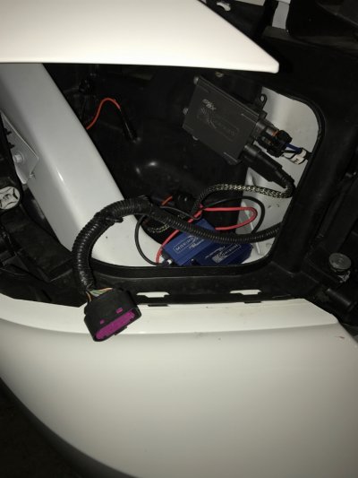

Has anyone swapped the halogen housing to projector housings at the dealership before? If so how much did it run you? My dad wants to swap his headlamps out for headlamps like mine and get the HID kit I have. Can anyone give him an idea on cost. I'm sure it's going to be a whole new wiring harness to get it done. 156826a293b21cca4c65798f9e80b578.jpg5bd208abba29918160b155dea1501464.jpg

No I've already did the HIDs in my projectors I know those components. I just was wondering how much it is to change the reflector housings to projector housings and the harness for the projector housings since there is no way that they're the same. As in taking his reflector housing and converting them to the halogen projector housings then after the fact installing the HID kit. 332822ba2ad738e14dd891fb2f6d975a.jpg
