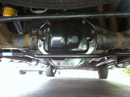

go to dodges site and put your VIn in and see if it needs to be done. Dodge might not have complete records for your truck. I know there was recalls for my stratus but never got them and I bought it new.
If the recall was done youd have this rear diff cover.

no paint burn off. thats dumb and the rear end wouldnt get that hot to burn anything off. Maybe they got fluid on the exhaust?
THis is mine after a few thousand miles on it. Looks the same as my other pic that was the next day after they did the TSB.
