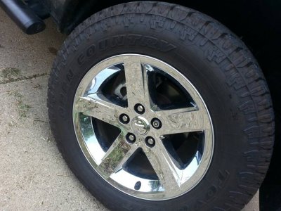

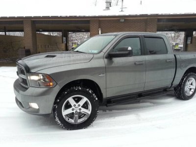

My 275/65/20 on stockers...

One more...
