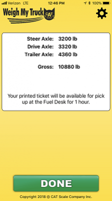

I weighed the truck at a CAT scale, then with the trailer with a little water in the fresh tank, then filled the fresh water tank to overflowing. I loaded most everything into the trailer because at some point I want to have my dirt bike in the bed of the truck.

Truck + trailer with full water tank, same WDH:
  • front axle 3200
  • rear axle 3320
  • truck total weight 6520
  • trailer axle 4360
  • trailer weight 4920
  • combined weight 10880
  • tongue weight 560 (11% trailer weight)

Because Internet. After reading a few threads about trailer sway and tongue weight, what seems straightforward at first enough starts to keep you up at night with worry. You have all your loved ones aboard, there's a great deal of money invested, etc.
Safe, comfortable towing really boils down to staying within payload and keeping the correct tongue weight percentage, and having a well adjusted WDH. Payload is used up by options on the truck, that's why the door sticker payload is important. But what your really have to do is just weigh the thing. The best way to do that IMHO is to use a CAT scale station. It's really easy. The most complicated part is setting up the account due to name, address, billing info, account activation, etc. Then you download an app to your phone, and then drive on the scale for a weighing. The app does all the communication and they bill you $11.50 and send you a PDF, or you can screenshot like below.
With the numbers below two weighings, you can calculate trailer weight and tongue weight. Weigh the truck alone, and weigh the truck & trailer. Trailer weight is the truck & trailer gross - truck gross. Tongue weight is the trailer weight - trailer axle.
I'm an engineer, I like numbers that work out correctly. YMMV.
