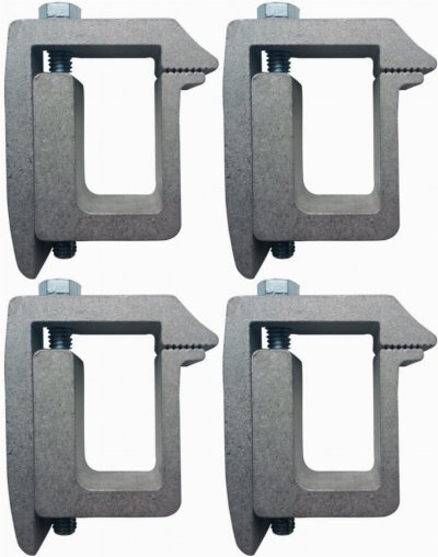

I'm not sure how you are attaching your cap but these have kept my ARE from spreading although I'm using six clamps.
