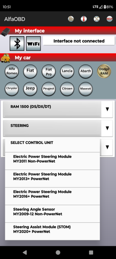

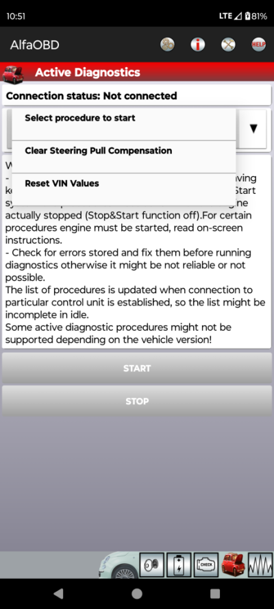

Just to clarify, Im not certain, but I believe that if it is a new steering gear and has never been installed, your trucks PCM will accept it.
If it's a used one, you may have to initialize it with a scanner or AlfaOBD or something, or you'll get a VIN mismatch error. With a rebuilt unit, I have no idea. I'd assume it still has the VIN from its previous life in memory, but maybe the rebuilder cleared it?
OEM is cheaper than $2000 for an aftermarket RockAuto unit. This is the one I used in my 2013.
Note that MoparPartsGiant says it "doesn't fit", my truck. It fits fine and has been working perfectly since Feb 2024.
Edit: To initialize it, connect to Ram 1500 DS, steering, MY 2013+ Powernet:
Then reset vin values
Then hit start.

@Ken226 Thanks for the information. To clarify, you did or did not have to go through the process with the alphaobd?
Ken226
Mar 12, 2017
2,293
5,933
Washington State
I did not.
Others who have bought used, or rebuilt units have had to use alfaOBD.
Mine was a brand new Mopar unit and worked right out of the box.
