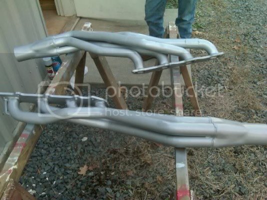

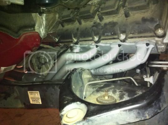

Alright so I got it all installed and boy is she nasty!!! Opened her up a lot and the diablo tune helped also. The muffler was the best I've ever had. Magnaflow is awesome. Quiet when cruising but loud when you get on it and has a great sound.
Here are the pics Magnaflow 18" big body muffler, pacesetter LT's, Pacesetter Y-Pipe

Hey captain, make sure you keep an eye on your header bolts and the gasket. I did Pacesetter LT's and 1 month after my gasket desintegrated. After replacing the gasket with a mopar steel OEM gasket my leak went away, but the bolts kept loostening. After a set of stage 8 locking header bolts... Ive never had a problem. So just in case, check them every week or so for a couple months, just to ensure you dont have a problem.
is that the silver vht coating?
That's how mine came. They were coated with some heat treatment stuff. Thought it would be black, but it was a dull grey.
