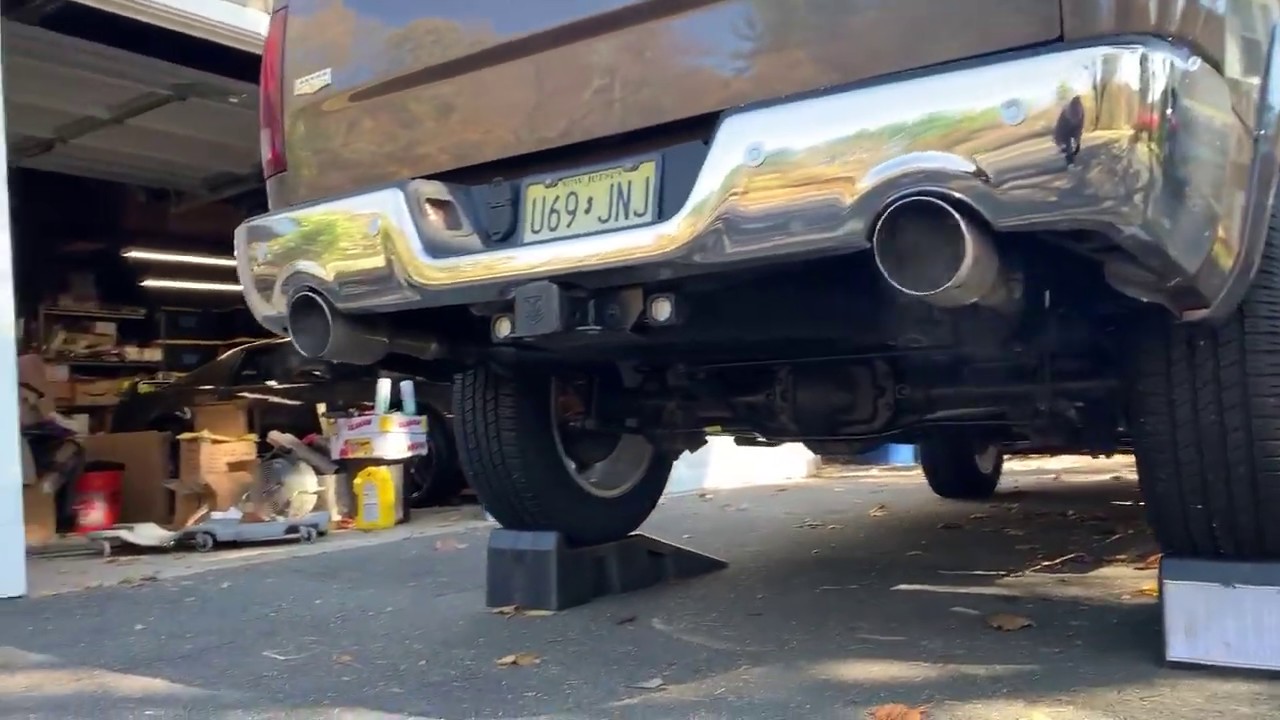

The borla Part# 40349 is a 19" case muffler, so it's going to be quieter than a 14" case. Also should be a near direct swap for a dual exhaust truck. I had the 14" case pro xs on my outdoorsman with single exhaust and it sounded damn good without being too loud. I feel the 19" should get you close to where you want to be. Here's a few videos to give you an idea of noise levels.
The pro xs does a good job of knocking down noise levels and producing a quality sound.
