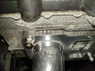

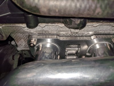

Hey guys, still in the middle of my header install... It's been a huge pita and I would have definitely paid to have it done in hindsight. Had to cut my catback to get the old y-pipe off :(.
I got new OEM gaskets, but after comparing them to the JBA gaskets, I started to put the JBA gaskets on since the OEM gaskets seemed to slightly block the primaries. I've got the passenger side on, but the gasket looks like it's got some gaps. I'd rather not take it off and put the OEM gaskets on since it was a huge pita. All bolts are hand tight. Check out the pic, am I crazy or is something not quite right?IMG_20171216_171226.jpg IMG_20171216_171215.jpg

When you tighten them it should close those gaps, I would go ahead and torque them down and check for more gaps

Should have used the oem gaskets man. Everyone on here with headers will tell you that.

It may be that since the exhaust ports are raised that having part of the gasket compressed could push the part that is not compressed away from the flange. I used the jba gaskets with no issues
I know, I know... But the gasket seemed like it blocked a bit of the exhaust discharge... This is my most frustrating experience on a vehicle ever. It's not my first header install and I've done numerous tranny swaps that we're a cake walk comparatively. I'm probably about 12 hours in... Had to cut my catback, stripped an O2 sensor, a stage 8 bolt disappeared somehow between the header and floor, can't get the lower dipstick bolt lose, and now the gasket. About ready to run the damn thing without exhaust lol

That's odd as hell with the bolts tightened down. That seems to be a pretty good size gap from what I can see in the pictures. I don't have JBA's but mine did not have any gaps after tightening the bolts down. When I tightened them down it pulled everything flush. By the way "the passenger side is the easy one" lol.
That's why I started there lol. I think I'm going to have to roll the dice. I finally got the dipstick bolt lose, but can't get it out all the way. Jacking up the engine and removing the motor mount isn't feasible due to the truck being lifted... I barely got it on jack stands. Consequently I cut the lower bracket and ended up cutting into the dipstick tube slightly... Looks like I'll be calling Loki on Monday... It's going to be a long week.

Also worth noting, I scrpaped the area prior to ensure carbon deposits didn't affect the seal

Looks like you need to check header flange with a straight edge.
They may have warped in welding process or forgot to machine after welding.
I think like another member stated in a previous post, that it may not be an issue since the flanges are raised. At this point, I'm going to roll the dice and if it leaks, I'll have a shop install the OEM gaskets... I'm over it. The stage 8 retainers are going on and I'm working on the y pipe to catback connection on the passenger side today. Driver side will have to wait until I get the dipstick issue figured out.
