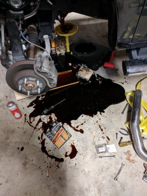

Well... The good news... What else could go wrong, right? Oh... IDK... Maybe this....
And no... The rest of the tube didn't come out...

Damn. I think I’m going to look into a shop doing my headers when the time comes so I don’t have to deal with any of that. Plus by then my header bolts will be seized in there and I don’t want to have to fight that
Yeah I guess you experienced my worst fear when I did mine. Sorry you have to go tru all this. Maybe it's still in there and a small magnet can get it out or a piece of solid copper wire with a hook at the end?
Don't have a magnet small enough, nor does AutoZone... Just finished pulling all the pan bolts... But it looks like there is another brace that's also bolted into the bell housing? I'm a bit weary on unbolting that... Time to consult the googles.
