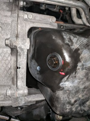

Anybody know what this silver brace attached to the tranny housing is all about? If I can just unbolting that, I'm thinking I may be able to get enough clearance to get into the oilpan to fish the piece of tube out.

Try jacking the truck in a way that would make piece roll toward oil drain.
Then blow air with nozzle on opposite of drain. May have construct air nozzle with extension (brake line) & curve to get in pan. Might get lucky & blow thru dip stick tube hole. Hope you have air compressor, good luck!
I've got a 6 inch lift with 37's, I barely got it up enough to get the tires off lol. Plus the broken piece is probably over a half inch in length, I think getting it in the drain hole is lottery odds. Finally, no air compressor... I have many tools, some which can't probably be imagined, but I've always found comfort wrenching on vehicles by hand... Not this time... Not by a long shot

Doesn't the pickup tube have a screen on it? That piece will never get picked up if there's a screen and will eventually get stuck on the drain plug magnet.

Directions say raise engine,drop the front axle and maybe even raise the transmission?! There's gotta be a better way.
If you haven't broke the oil pan loose yet,just leave it alone,and as stated wait till the piece gets stuck to the drain plug,it's not gonna hurt anything laying in the pan. find your local Snap-on or Matco tools dealer,they'll have a small extendable magnet that should fit through the drain plug hole. If you're really worried about the piece,find a good sized magnet and stick it to the outside of the pan by the drain plug,that'll keep the piece trapped till you can get yourself a small magnet.
I was going to suggest the same thing. Get yourself a really large magnet and see if you can move that broken piece towards the drain hole and then try to fish it out with something.
I've already broken the pan loose, was planning on removing the "structural dust cover" bolted to the bell housing to get at the rest of the bolts. Just read that the gasket is actually a windage tray with the pickup tube going through. If I can get away with just bolting it backup, I'd rather go that route. 56$ for a new windage tray from the dealer and having to mess with trying to unbolting the pickuptube with minimal clearance sounds like a nightmare. You guys think I'll really be ok with that piece still in there?
