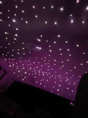

Here are some pics of the final product, I was able to get away with just dropping the headliner and working on it inside the vehicle. I’m very happy with the way it turned out. It looks amazing at night and even during the day, the only way you could know that they’re there is during the day when the lights aren’t on because of the tiny holes in the headliner.
