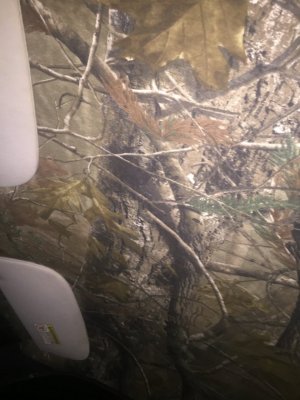

I just redid mine on the flatbed the other day,
the fabric from joans with my coupon code was about $20 and the can of 3m yellow spray stuff from autozone was $25. They have a cheaper headliner spray, but I figured 3m and only do it once.
