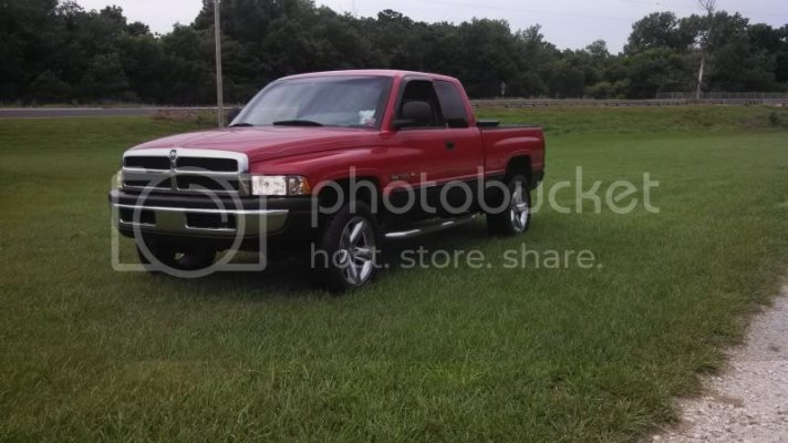

5.9 Magnum 360

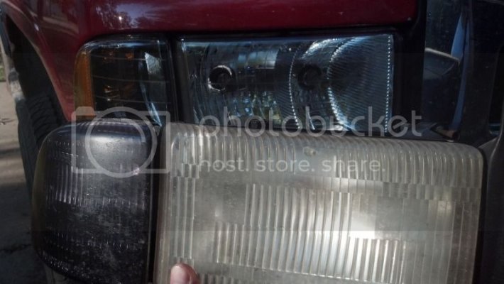

Best thing I ever did for my truck is upgraded. From the single bulb headlights to dual bulb sport lights. I run sport lights and Silverstars. I barely turn on my brights anymore and I use to always drive with them on with my old lights. I bought a coversion on ebay which came with the wiring for 150 they are TYC lights and still look brand new over a year later. I did rewire the wiring with relays so that the low and high beams turn on at the sametime like a sport would.
the lights
94 02 Dodge RAM Sport Pickup Conversion Headlamps Headlights Kit New | eBay
You can see how bright the lights are.
Big difference
Thats a good upgrade, +1 on doing that!
Truck looks sharp to btw ;)

my lenses are like new still, its been garaged all it life. It only has just over 96k miles on it as of now. I am looking at the halo sport lights. That's if i get new lenses.

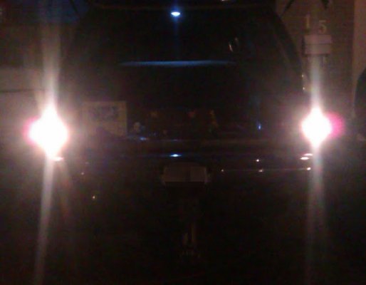

before you go wasting any money on upgrading bulbs or housings you should put your headlights on relays. putting your headlights on relays can make a noticeable difference to the amount of light put out. it also saves your headlight switch and wiring from burning up.
this picture is not the greatest but think it still makes my point. one of the backup lights on 93 is on relays and it is noticeably brighter.

Thanks. I love the setup I have now. I'm running relays to get power directly from the battery and also running a relay so my lows and high beams are on when my highs are on. Its night and day difference. I had PIAA in all my trucks I have ever owned till this one. (now with two kids couldn't justify the cost) my silverstars do just as well as my PIAAs ever did. Plus the high beams are the ones that came in my old headlights so they are 5+ years old and then the low beams I bought a year ago on ebay for under 30 bucks.
