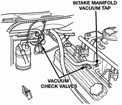

I have a similar problem. My heat works fine on all settings but if I'm heavy on the throttle, the heat stops flowing until I let off the throttle again. I think that this is often referred to as "wild vents."
Your problem is due to one of two things. A bad check valve, or a really bad leak. If your vents change strong when you are light on the throttle, then i'd go with the check valve.

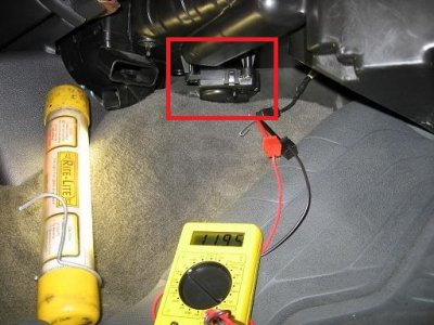

So what y'all are saying is there us a bad line that connects to the knob on the dash? And this line allows your blend door/vents to change settings.
Would this be why I have no gradual change between heat and cold settings? Everything works as far as vents, cool g and heating. I just don't have the option for a gradual setting. It's either hot or cold when I select
Sent from my HTC One_M8 using Tapatalk
The blend door is either cable driven or servo driven depending on year, it is not vacuum actuated. To tell what your blend door is doing, look in the passenger footwell all the way left.
The attached picture is if you were looking in from the passenger door.
Right where the little servo attaches you should be able to see a shaft, that should rotate smoothly.
