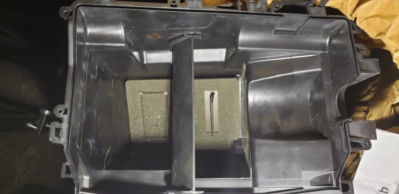

I'm not sure why the passenger side would be different. I haven't had a regular cab apart but I can't see them being any different that the Crew Cab and Quad Cab and I have had both of them apart and the the single zone only has the one door for heat. There are actually two different air channels for driver and passenger that are controlled by one door that pivots between the two. I'm thinking it may be possible that the actual blend door broke and the passenger side is not moving with the driver's side. I actually removed mine to install Dual Zone so I still have my old Single Zone unit. I will see if I can dig it out and send you some pics of the actual door so you can see what I'm talking about.

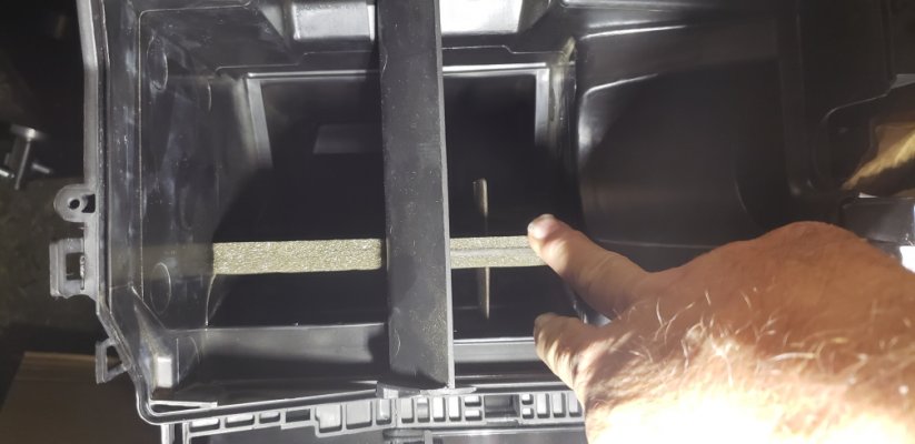

Ok this is s pic of the actual blend door. As you can see one door controls both sides in the Single Zone application. The Dual Zone looks identical but the door is not one piece and pivots in the middle and the side of the door that controls the passenger side is the one I'm touching. On the Dual Zone that blend door motor is the one mounted to the back of the HVAC box to control that side but the Si gle Zone like this one just has the blend door motor in the front. I checked the door and it definitely had some flex but seems like it would be unlikely it would break at the pivot it the middle but it's possible. Another idea is that possibly something is blocking some of the air flow in the actual blend door or surrounding area. Possibly some type of nest or other issue. 59c7e647115ec8c4569739c4e5495b02.jpga01de2c4b807e4692fe3d10f80b88742.jpg

so I opened up part of the dash and I tested all the actuators and they seem to be in good working order, I got a look inside and there isn’t anything blocking it that I can see without ripping the whole dash out of my truck, I’m seriously stumped on this one.
