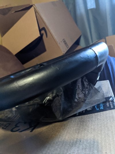

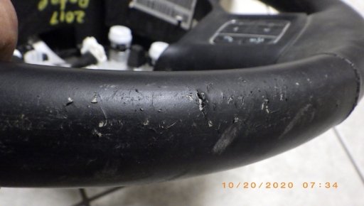

Buy a can of vinyl and fabric dye, spray the wheel. Best of you remove it from truck, or if you can't, tape and cover everything in newspaper or plastic. SEM and duplicolor both make good products. I just bought a leather wheel to put in my 19 classic express. The leather was damaged by the broken windshield in donor truck. I repaired it. Then dyed it. Looks almost like new.
