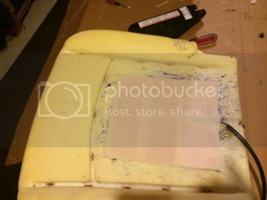

I have a 2012 cc express and i just installed a kit i purchased from amazon. It works great and all necessary wiring is included. The hardest part was running the wires under the carpet to give it a factory appearance. Had to remove both seats and the middle jump seat. If you dont want to use hog rings( can be a pita) zip ties work just as well. Good luck.
