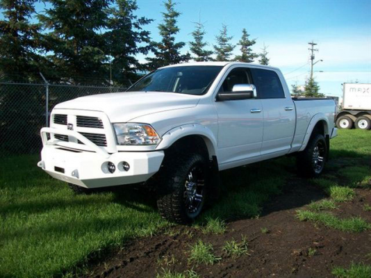

Try these guys. Truly tough bumpers and far less weight. Half the oil patch runs these with a winch and they still come in under 400 pounds. They will take a hit from a deer with no problems. Being Canadian Dollars your cost is 75% of the posted price.
2010-2018 weighs 160 Lbs and $2450 Canadian.
The next one down with the full Wraps is 210 pounds.
