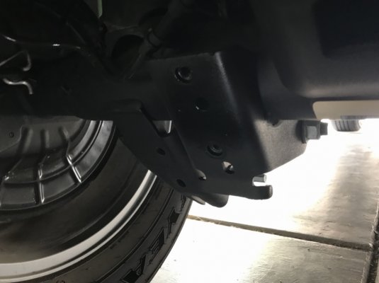

3. I sprayed black rustoleum on the axle as a precaution since there was some orange spots under the stock bushing. See pic below.
Ride was a little squishy at first but then firmed up nicely after the swaybar settled in. I found myself looking for uneven roads and taking faster turns lol. So much more fun to drive now.
Finished install:
Orange stain on axle:
After painting with black rustoleum:
