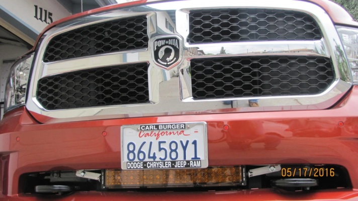

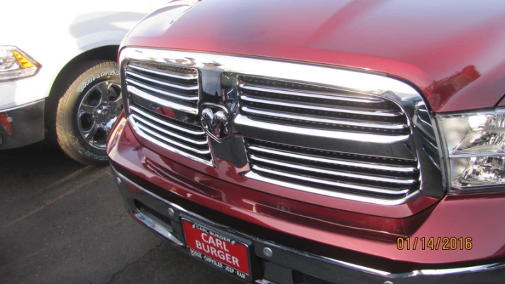

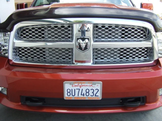

GTyankee
Nov 2, 2020
12,391
17,459
El Cajon Calif. 92021
3.0 ecodiesel
bottom corners of the grilles & top corners of the Ram emblems are different
& of course, the Fog Lights did change
