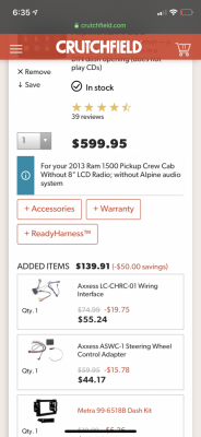

Thought the same thing. First thing I tried was the axxess LC-CHRC-01 now I just tried the PAC RP4-CH21.
it’s a 2013. Just needing the steering wheel controls retained as this stereo has CarPlay and I’m running a usb to the back of it so I won’t need center console one.

I would call Crutchfield directly if you haven't already. When searching your setup it actually gives three harness options.
