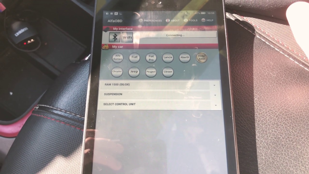

maybe resetting the air suspension will level it out using the alfaobd ?

I've been looking for a lot of information
It has been confirmed that the four heights can be adjusted through alfaobd.
There is a video I referred to, so I will share it with you.
