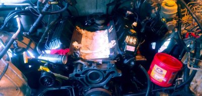

Doing maintenance on her so far I cleaned the intake manifold an throttle body replaced gaskets .. exhaust manifold cleaned it put new gaskets on.. Replaced water pump what woes should I do or have done

318/360?
Belly pan gasket (underside of the intake manifold).

She is a 318.. Looking for anything to make her better then she was I am doing all my own work on it

Definitely do the distributor cap and rotor or you can replace whole distributor. I just did mine on a 96 that I just bought. You wouldn't want to have to do it once the keg is back on.
While it's off, replace the plenum plate with an aluminum one,
Also good time to replace oil sending unit an temp sensors.
