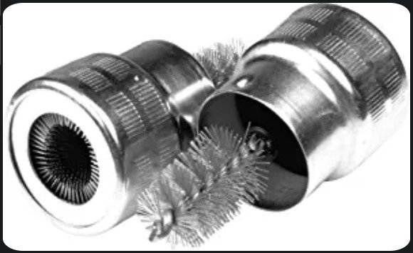

One of these from HarbourFreight is dirt cheap (<$5) and very effective.

I've attached a file that directs you to many of the larger common ground points. They often get caked with corrosion or break off and require refurbishing.
